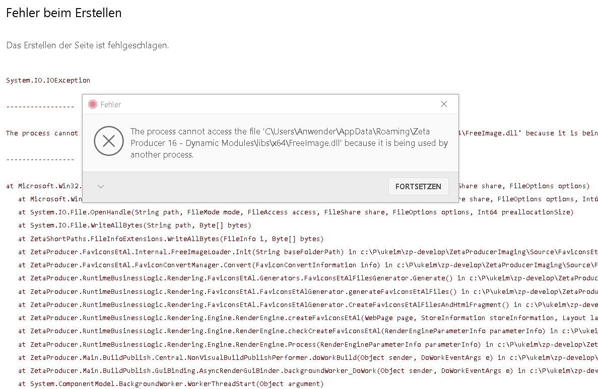

Kannst Du mir bitte den gesamten roten Text aus dem Bildschirmfoto hier als Text einfügen, so dass er nicht abgeschnitten ist.

Wie gewünscht der Komplette Text....

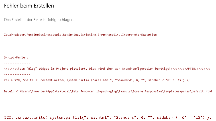

Fehler beim Erstellen
Das Erstellen der Seite ist fehlgeschlagen.
Alles anzeigenSystem.IO.IOException ----------------- The process cannot access the file 'C:\Users\Anwender\AppData\Roaming\Zeta Producer 16 - Dynamic Modules\libs\x64\FreeImage.dll' because it is being used by another process. ----------------- at Microsoft.Win32.SafeHandles.SafeFileHandle.CreateFile(String fullPath, FileMode mode, FileAccess access, FileShare share, FileOptions options) at Microsoft.Win32.SafeHandles.SafeFileHandle.Open(String fullPath, FileMode mode, FileAccess access, FileShare share, FileOptions options, Int64 preallocationSize, Nullable`1 unixCreateMode) at System.IO.File.OpenHandle(String path, FileMode mode, FileAccess access, FileShare share, FileOptions options, Int64 preallocationSize) at System.IO.File.WriteAllBytes(String path, Byte[] bytes) at ZetaShortPaths.FileInfoExtensions.WriteAllBytes(FileInfo i, Byte[] bytes) at ZetaProducer.FaviconsEtAl.Internal.FreeImageLoader.Init(String baseFolderPath) in c:\P\ukeim\zp-develop\ZetaProducerImaging\Source\FaviconsEtAl\Internal\FreeImageLoader.cs:line 31 at ZetaProducer.FaviconsEtAl.FaviconConvertManager.Convert(FaviconConvertInformation info) in c:\P\ukeim\zp-develop\ZetaProducerImaging\Source\FaviconsEtAl\FaviconConvertManager.cs:line 73 at ZetaProducer.RuntimeBusinessLogic.Rendering.FaviconsEtAl.Generators.FaviconsEtAlFilesGenerator.Generate() in c:\P\ukeim\zp-develop\ZetaProducerMain\Source\Core\RuntimeBusinessLogic\Rendering\FaviconsEtAl\Generators\FaviconsEtAlFilesGenerator.cs:line 60 at ZetaProducer.RuntimeBusinessLogic.Rendering.FaviconsEtAl.FaviconsEtAlGenerator.generateFaviconsEtAlFiles() in c:\P\ukeim\zp-develop\ZetaProducerMain\Source\Core\RuntimeBusinessLogic\Rendering\FaviconsEtAl\FaviconsEtAlGenerator.cs:line 34 at ZetaProducer.RuntimeBusinessLogic.Rendering.FaviconsEtAl.FaviconsEtAlGenerator.CreateFaviconsEtAlFilesAndHtmlFragment() in c:\P\ukeim\zp-develop\ZetaProducerMain\Source\Core\RuntimeBusinessLogic\Rendering\FaviconsEtAl\FaviconsEtAlGenerator.cs:line 26 at ZetaProducer.RuntimeBusinessLogic.Rendering.Engine.RenderEngine.createFaviconsEtAl(WebPage page, StoreInformation storeInformation, Layout layout) in c:\P\ukeim\zp-develop\ZetaProducerMain\Source\Core\RuntimeBusinessLogic\Rendering\Engine\RenderEngine.Processing.cs:line 798 at ZetaProducer.RuntimeBusinessLogic.Rendering.Engine.RenderEngine.checkCreateFaviconsEtAl(RenderEngineParameterInfo parameterInfo) in c:\P\ukeim\zp-develop\ZetaProducerMain\Source\Core\RuntimeBusinessLogic\Rendering\Engine\RenderEngine.Processing.cs:line 512 at ZetaProducer.RuntimeBusinessLogic.Rendering.Engine.RenderEngine.Process(RenderEngineParameterInfo parameterInfo) in c:\P\ukeim\zp-develop\ZetaProducerMain\Source\Core\RuntimeBusinessLogic\Rendering\Engine\RenderEngine.Core.cs:line 69 at ZetaProducer.Main.BuildPublish.Central.NonVisualBuildPublishPerformer.doWorkBuild(Object sender, DoWorkEventArgs e) in c:\P\ukeim\zp-develop\ZetaProducerMain\Source\Core\Main\BuildPublish\Central\NonVisualBuildPublishPerformer.cs:line 698 at ZetaProducer.Main.BuildPublish.GuiBinding.AsyncRenderGuiBinder.backgroundWorker_DoWork(Object sender, DoWorkEventArgs e) in c:\P\ukeim\zp-develop\ZetaProducerMain\Source\Core\Main\BuildPublish\GuiBinding\AsyncRenderGuiBinder.cs:line 372 at System.ComponentModel.BackgroundWorker.WorkerThreadStart(Object argument) IOException { TargetSite=RuntimeMethodInfo: CreateFile, Message="The process cannot access the file \\'C:\\Users\\Anwender\\AppData\\Roaming\\Zeta Producer 16 - Dynamic Modules\\libs\\x64\\FreeImage.dll\\' because it is being used by another process.", Data= [ ] , InnerException=null, HelpLink=null, Source="System.Private.CoreLib", HResult=-2147024864, StackTrace=" at Microsoft.Win32.SafeHandles.SafeFileHandle.CreateFile(String fullPath, FileMode mode, FileAccess access, FileShare share, FileOptions options)\\r\\n at Microsoft.Win32.SafeHandles.SafeFileHandle.Open(String fullPath, FileMode mode, FileAccess access, FileShare share, FileOptions options, Int64 preallocationSize, Nullable`1 unixCreateMode)\\r\\n at System.IO.File.OpenHandle(String path, FileMode mode, FileAccess access, FileShare share, FileOptions options, Int64 preallocationSize)\\r\\n at System.IO.File.WriteAllBytes(String path, Byte[] bytes)\\r\\n at ZetaShortPaths.FileInfoExtensions.WriteAllBytes(FileInfo i, Byte[] bytes)\\r\\n at ZetaProducer.FaviconsEtAl.Internal.FreeImageLoader.Init(String baseFolderPath) in c:\\P\\ukeim\\zp-develop\\ZetaProducerImaging\\Source\\FaviconsEtAl\\Internal\\FreeImageLoader.cs:line 31\\r\\n at ZetaProducer.FaviconsEtAl.FaviconConvertManager.Convert(FaviconConvertInformation info) in c:\\P\\ukeim\\zp-develop\\ZetaProducerImaging\\Source\\FaviconsEtAl\\FaviconConvertManager.cs:line 73\\r\\n at ZetaProducer.RuntimeBusinessLogic.Rendering.FaviconsEtAl.Generators.FaviconsEtAlFilesGenerator.Generate() in c:\\P\\ukeim\\zp-develop\\ZetaProducerMain\\Source\\Core\\RuntimeBusinessLogic\\Rendering\\FaviconsEtAl\\Generators\\FaviconsEtAlFilesGenerator.cs:line 60\\r\\n at ZetaProducer.RuntimeBusinessLogic.Rendering.FaviconsEtAl.FaviconsEtAlGenerator.generateFaviconsEtAlFiles() in c:\\P\\ukeim\\zp-develop\\ZetaProducerMain\\Source\\Core\\RuntimeBusinessLogic\\Rendering\\FaviconsEtAl\\FaviconsEtAlGenerator.cs:line 34\\r\\n at ZetaProducer.RuntimeBusinessLogic.Rendering.FaviconsEtAl.FaviconsEtAlGenerator.CreateFaviconsEtAlFilesAndHtmlFragment() in c:\\P\\ukeim\\zp-develop\\ZetaProducerMain\\Source\\Core\\RuntimeBusinessLogic\\Rendering\\FaviconsEtAl\\FaviconsEtAlGenerator.cs:line 26\\r\\n at ZetaProducer.RuntimeBusinessLogic.Rendering.Engine.RenderEngine.createFaviconsEtAl(WebPage page, StoreInformation storeInformation, Layout layout) in c:\\P\\ukeim\\zp-develop\\ZetaProducerMain\\Source\\Core\\RuntimeBusinessLogic\\Rendering\\Engine\\RenderEngine.Processing.cs:line 798\\r\\n at ZetaProducer.RuntimeBusinessLogic.Rendering.Engine.RenderEngine.checkCreateFaviconsEtAl(RenderEngineParameterInfo parameterInfo) in c:\\P\\ukeim\\zp-develop\\ZetaProducerMain\\Source\\Core\\RuntimeBusinessLogic\\Rendering\\Engine\\RenderEngine.Processing.cs:line 512\\r\\n at ZetaProducer.RuntimeBusinessLogic.Rendering.Engine.RenderEngine.Process(RenderEngineParameterInfo parameterInfo) in c:\\P\\ukeim\\zp-develop\\ZetaProducerMain\\Source\\Core\\RuntimeBusinessLogic\\Rendering\\Engine\\RenderEngine.Core.cs:line 69\\r\\n at ZetaProducer.Main.BuildPublish.Central.NonVisualBuildPublishPerformer.doWorkBuild(Object sender, DoWorkEventArgs e) in c:\\P\\ukeim\\zp-develop\\ZetaProducerMain\\Source\\Core\\Main\\BuildPublish\\Central\\NonVisualBuildPublishPerformer.cs:line 698\\r\\n at ZetaProducer.Main.BuildPublish.GuiBinding.AsyncRenderGuiBinder.backgroundWorker_DoWork(Object sender, DoWorkEventArgs e) in c:\\P\\ukeim\\zp-develop\\ZetaProducerMain\\Source\\Core\\Main\\BuildPublish\\GuiBinding\\AsyncRenderGuiBinder.cs:line 372\\r\\n at System.ComponentModel.BackgroundWorker.WorkerThreadStart(Object argument)" } -
Ich kann das nachvollziehen. Und aus meiner Sicht lokal auch schon beheben, Hotfix (neues Setup) folgt, ich melde mich später hier wieder.

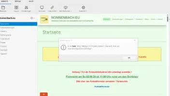

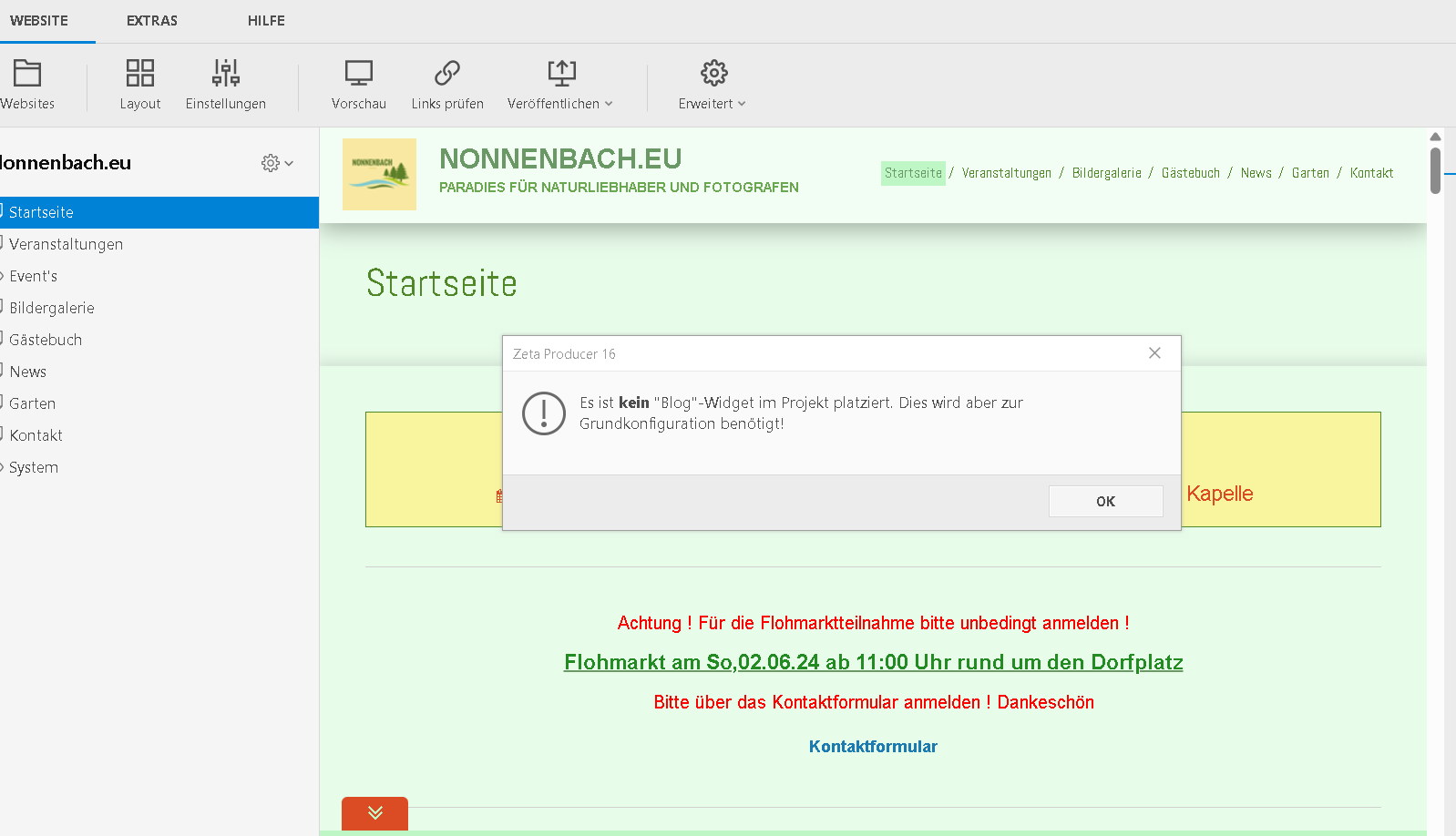

Dann haben Sie irgendwo im Projekt das Widget "Blog-Artikel" verwendet, aber kein "Blog"-Widget platziert. Sie müssen entweder den / die Blogartikel löschen oder auf einer Seite das "Blog" Widget einfügen.

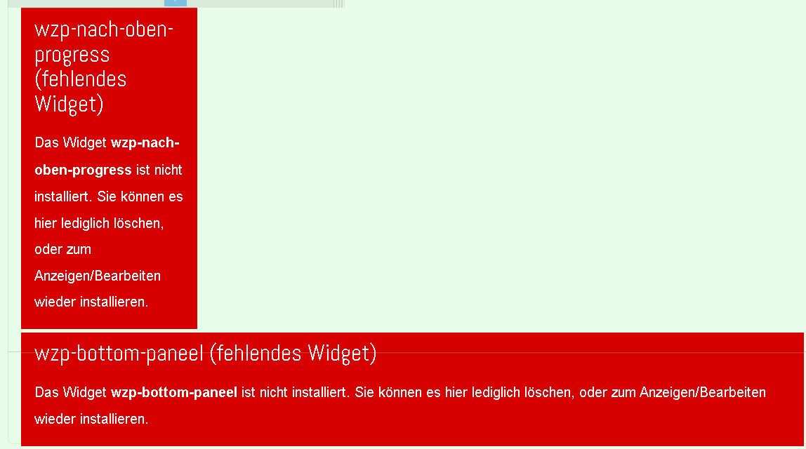

Habe jetzt mal nachgeschaut, es ist kein Blog Artikel verwendet worden und nach der Neu Installation fehlen mir auch ein paar Widgets.
Es hat vor der Installation von 16.8.5 keine Probleme gegeben. Hm was nun ?
Da müssen Sie vermutlich diese Fremdwidgets wieder installieren.

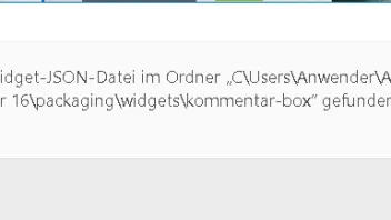

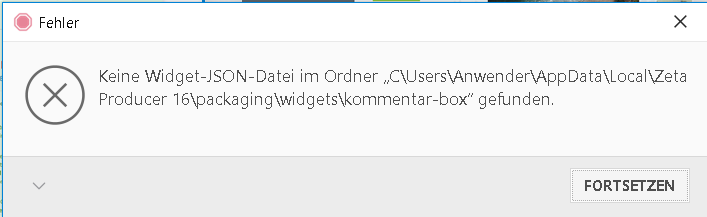

Habe eine alte 16.0.0 Version gefunden und installiert. Da bekomme ich beim Starten (jedes mal) folgenden Fehlermeldungen und das Programm öffnet sich danach nicht.
Ich vermute, da hat es irgendwie die Datei mit den Programm-Einstellungen zerschossen.
Bitte gehen Sie folgendermaßen vor:
- Beenden Sie Zeta Producer
- Navigieren Sie in den Ordner "Eigene Dokumente\Zeta Producer 16\"
- Dort sehen Sie einen Ordner namens "Settings" – benennen Sie diesen Ordner um in "Kaputte-Settings"
- Starten Sie Zeta Producer
Nun sollte Zeta Producer wieder normal starten. Evtl. wird Ihr letztes Projekt aber nicht automatisch geöffnet, das öffnen Sie dann einfach über den Button "Öffnen". Falls Sie nicht die kostenlose Version genutzt haben, müssen Sie auch Ihre erworbene Lizenznummer erneut eingeben. Wenn nun alles funktioniert, können Sie den Ordner "Kaputte-Settings" löschen.
