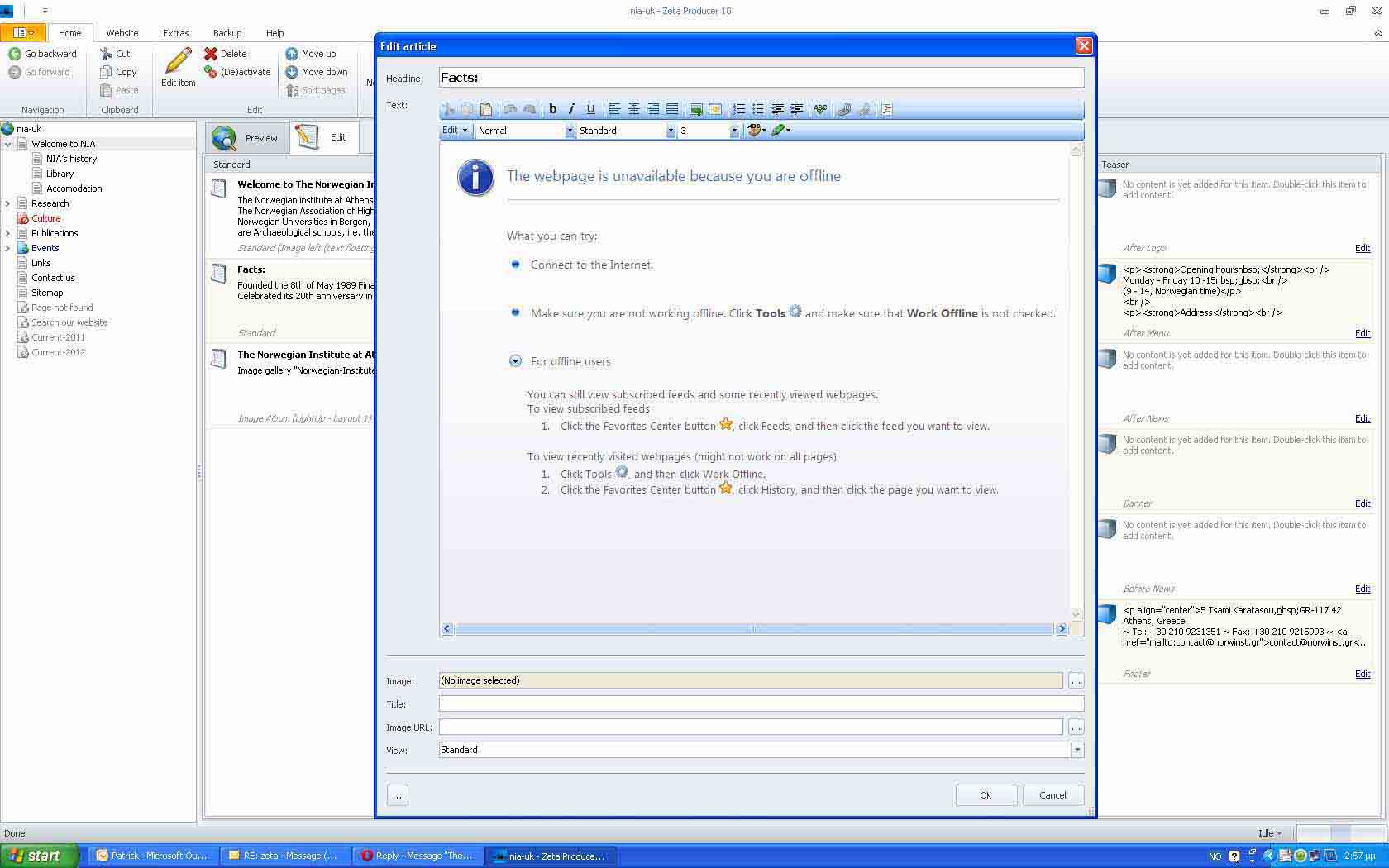

  • Suddenly I can not edit any page. I get the message "The website is unavailable because you are offline". But I am not offline. My internet access is working fine.
    What could be the problem please ? (Please answer me in English, I do not understand German)
  • The preview pane shows just a blank white page. The edit pane shows up like normal, but when I go to edit an article I just get the message noted above. Pressing show local website works fine, as does show folder, so clearly the problem is not with the website but with the program.
  • The program does not get access to the internet. Maybe the access is blocked by a security software. Please check this and disable any security software.
    Could you also send a screenshot and the detailed information of the error message?
  • The article-editor uses the engine of the Internet Explorer. The Internet Explorer (version 7 or higher) is a system requirement for ZetaProducer. Which version of Internet Explorer is installed? Wrong settings of the browser probably causing the problem.
  • 8.0.6001.18702
    But I generally use Opera, which is why I did not notice something was wrong with IE. I fixed the settings in IE and things are now working as they should. Thanks for the help.
