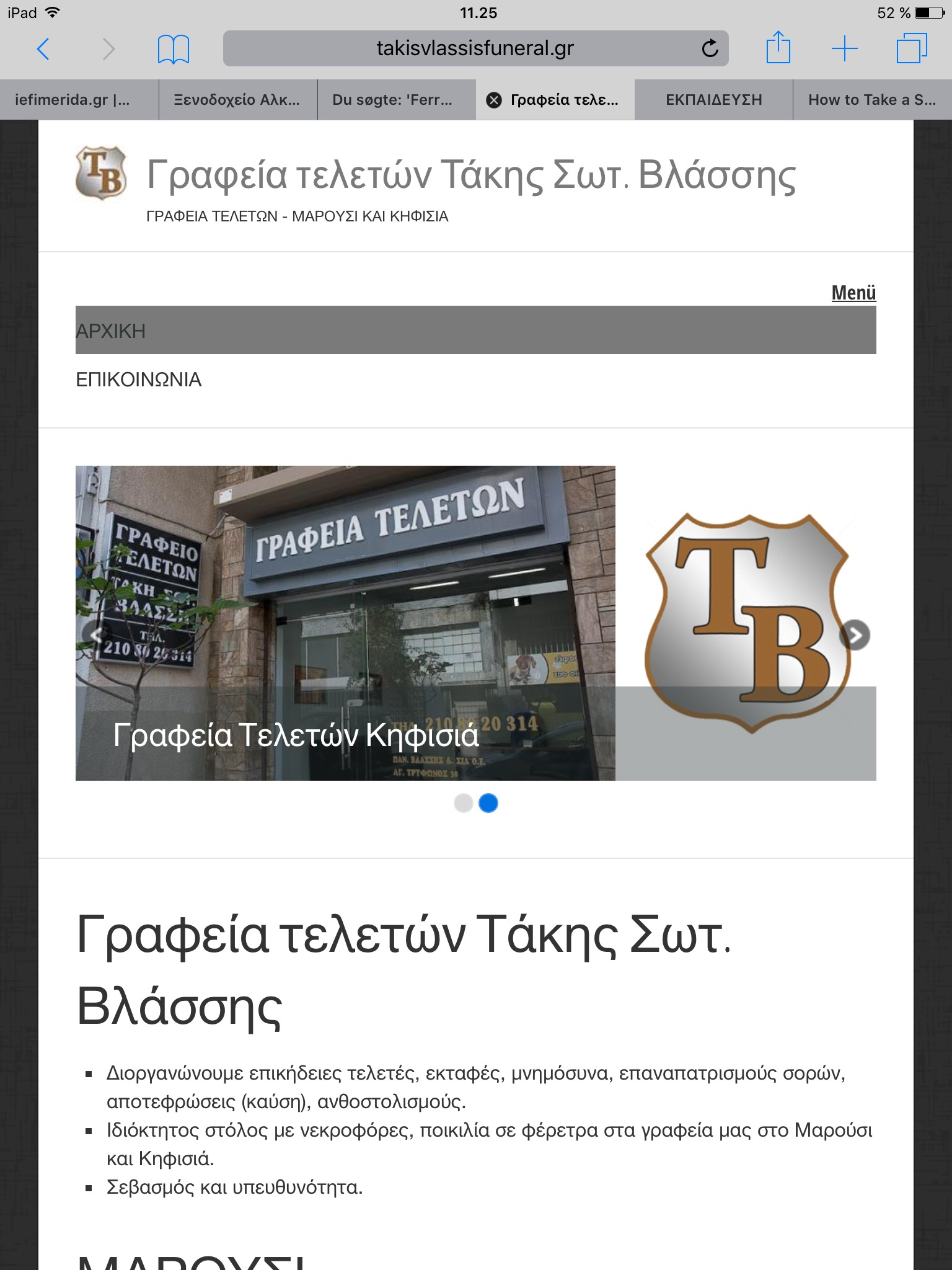

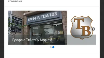

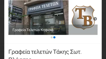

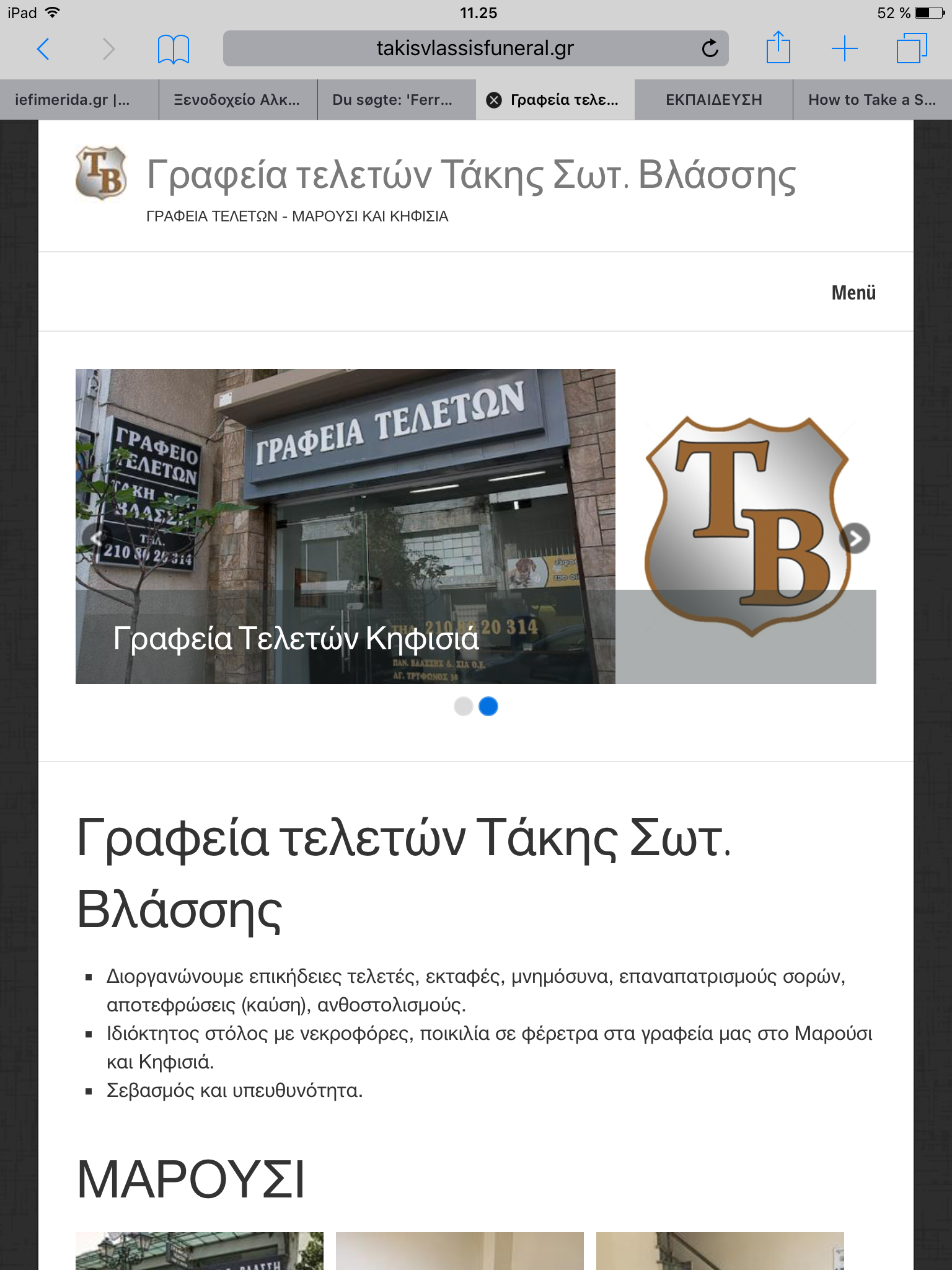

Dear Zeta,
I made a site in Zeta 12.5 using Clean Style Responsive. All is well apart from the navigation in mobile which has a fixed text in German MENÜ instead of the usual mobile menu icon (with the lines).
Surely this is a mistake?
For me the German is no go since my sites are in other languages - this one is in Greek. I hope you will change this in the next update?
I attach two screen shots from my ipad mini
Kind regards
Vibeke

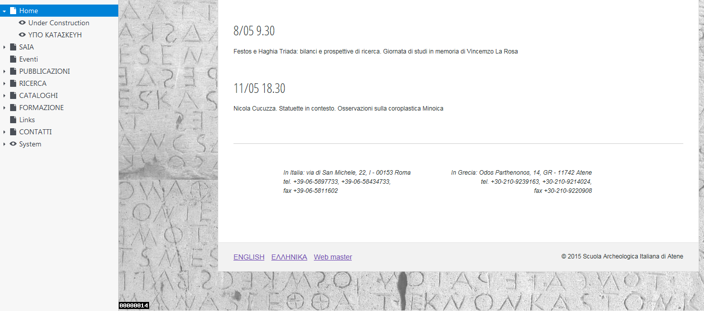

http://www.scuoladiatene.it/
The counter shows correctly when I am editing as you can see from the attached screen shot, but not in Vorschau nor online where only the characters show.
I have seen it before on sites I have made, but did not do anything about it, here for instance: http://www.mpeppa.gr/. Here the counter should be invisible and still the characters show.
Hello,
I have installed the tracking code from Statcounter (as attached) in the footer_script and it counts just fine. I am using ZP12, business.
The problem is that both when I install code for a visible and for an invisible counter these 3 characters are shown in the lower left corner ");
The visible counter is never shown.
Do you have any idea why this happens please?
Thank you for your help
Kind regrds Vibeke

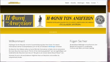

Hi Steffen, Thanks, Yes my mobile screenshot was taken in portrait.
Well, I imagined that there would be some scaling so that all the header could show.
Android 4.1.2. I use the built in android browser.
I upload a screen from mobile and one from desktop for comparison.
Kind regard v

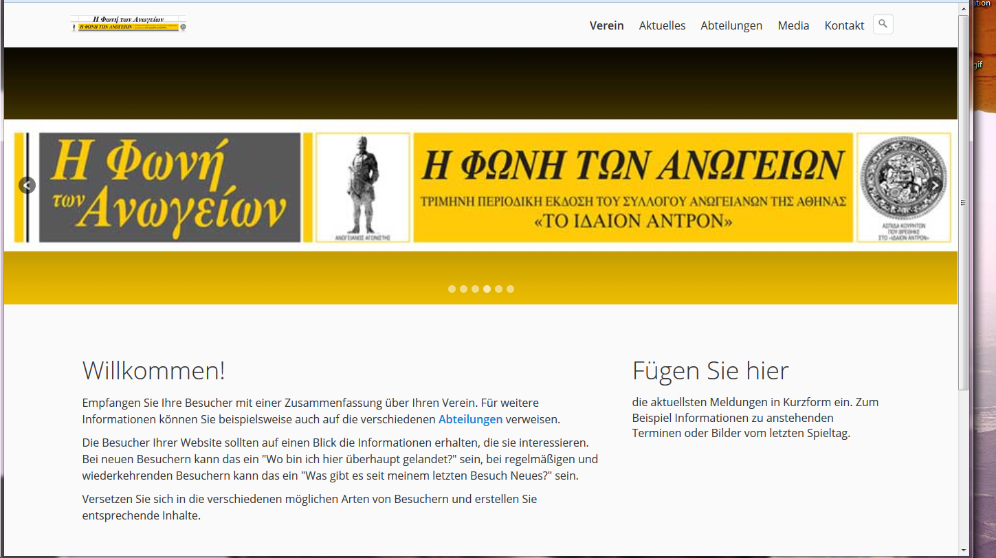

Hello,
Du you have some advice for making the header scale ok for mobile portrait and landscape. It looks ok when I check responsive layouts on my desktop, but not on Samsung Galaxy phone. On ipad mini portrait it is ok. I have ZP 12 business.
I have general width 1200, kopfgrafik 960*300.
I put some transparent text in the header to keep the height, but still it 'cuts' in each side.
I have some test examples here http://www.ifonitonanogion.gr/test2015/index.html
Thanks for any advice.
Kind regards vibeke

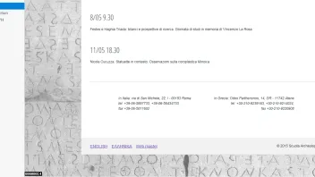

How can I change the language into English in these widgets? I have changed into EN the attributes so_date_language and so_date_time and in the Projektordner the language is also EN. But the titles are still in German.
I have zp12 business version.
Thanks for your help
Vibeke
