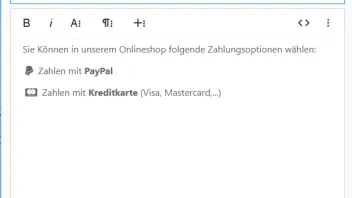

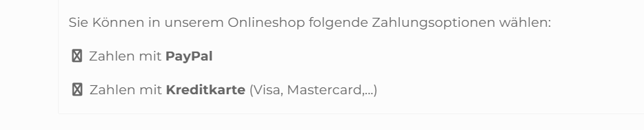

ich habe einen Tippfehler im html-Quellcode. Ich kann dies aber nicht mehr bearbeiten, dann stürzt zeta Producer immer ab.
Wie kann ich den Text bearbeiten?
Ursache im img-Pfad: oid://https//volksfest.stiftl.de/media/images/appendlist.svg

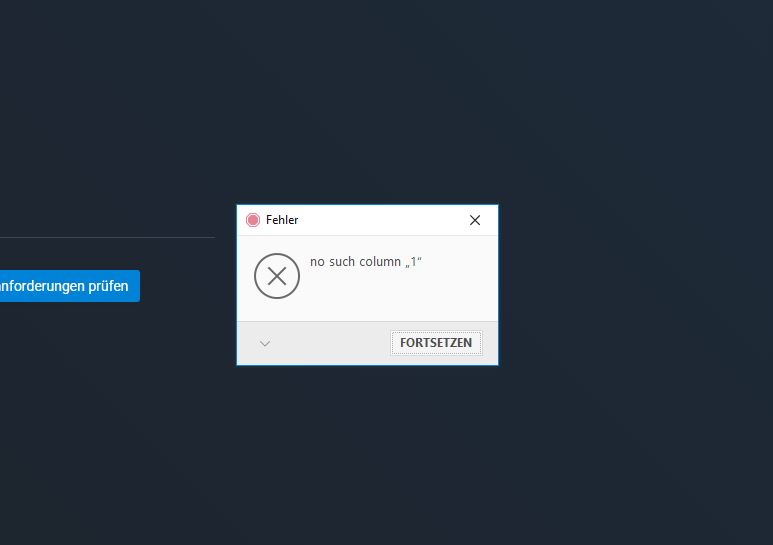

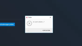

Okay ich bin grad Texte am einfügen und es kommt auch hier ab und an diese Fehlermeldung:
SQLite.SQLiteException
no such column: „1“
at SQLite.SQLite3.Prepare2(sqlite3 db, String query)
at SQLite.SQLiteCommand.Prepare()
at SQLite.SQLiteCommand.ExecuteNonQuery()
at SQLite.SQLiteConnection.Execute(String query, Object[] args)
at ZetaProducer.RuntimeBusinessLogic.Shop.LocalStorage.ShopContentUpgrader.set_currentConverterVersion(Int32 value) in C:\P\ukeim\zp-17.0\ZetaProducerMain\Source\Core\RuntimeBusinessLogic\Shop\LocalStorage\ShopContentUpgrader.cs:line 61
at ZetaProducer.RuntimeBusinessLogic.Shop.LocalStorage.ShopContentUpgrader.CheckUpgrade() in C:\P\ukeim\zp-17.0\ZetaProducerMain\Source\Core\RuntimeBusinessLogic\Shop\LocalStorage\ShopContentUpgrader.cs:line 30
at ZetaProducer.RuntimeBusinessLogic.Shop.LocalStorage.ShopLocalStorageController.GetDbConnection() in C:\P\ukeim\zp-17.0\ZetaProducerMain\Source\Core\RuntimeBusinessLogic\Shop\LocalStorage\ShopLocalStorageController.cs:line 61
at ZetaProducer.RuntimeBusinessLogic.Shop.Controllers.Primary.LocalBaseController`1.GetAll(Nullable`1 recursiveSelectOverride) in C:\P\ukeim\zp-17.0\ZetaProducerMain\Source\Core\RuntimeBusinessLogic\Shop\Controllers\Primary\LocalBaseController.cs:line 70
at ZetaProducer.RuntimeBusinessLogic.Webbing.Assets.Images.Usages.ImageAssetUsageDeterminationController.<>c__DisplayClass1_0.<GetUsages>b__1() in C:\P\ukeim\zp-17.0\ZetaProducerMain\Source\Core\RuntimeBusinessLogic\Webbing\Assets\Images\Usages\ImageAssetUsageDeterminationController.cs:line 505
at System.Lazy`1.ViaFactory(LazyThreadSafetyMode mode)
at System.Lazy`1.ExecutionAndPublication(LazyHelper executionAndPublication, Boolean useDefaultConstructor)
at System.Lazy`1.CreateValue()
at ZetaProducer.RuntimeBusinessLogic.Webbing.Assets.Images.Usages.ImageAssetUsageDeterminationController.GetUsages(WebImageAssetCollection imageAssets, Boolean onlyCheckHas) in C:\P\ukeim\zp-17.0\ZetaProducerMain\Source\Core\RuntimeBusinessLogic\Webbing\Assets\Images\Usages\ImageAssetUsageDeterminationController.cs:line 528
at ZetaProducer.RuntimeBusinessLogic.Webbing.Assets.Images.ImageAssetDeletionHelper.deleteImageIfNoOtherReferences(WebProject webProject, WebImageAsset image, Int32 articleID, Boolean isSymlinkTarget) in C:\P\ukeim\zp-17.0\ZetaProducerMain\Source\Core\RuntimeBusinessLogic\Webbing\Assets\Images\ImageAssetDeletionHelper.cs:line 326
at ZetaProducer.RuntimeBusinessLogic.Webbing.Assets.Images.ImageAssetDeletionHelper.DeleteReferedDeltaImages(WebProject webProject, Int32 articleID, StringObjectDictionary articleValuesBefore, StringObjectDictionary articleValuesAfter, Boolean isEntailRootArticle) in C:\P\ukeim\zp-17.0\ZetaProducerMain\Source\Core\RuntimeBusinessLogic\Webbing\Assets\Images\ImageAssetDeletionHelper.cs:line 241
at ZetaProducer.RuntimeBusinessLogic.Webbing.Dependencies.WebDependencyManager.<>c__DisplayClass3_0.<checkDependencies>b__0(ThreadQueueWorkItemCallbackParameters parameters) in C:\P\ukeim\zp-17.0\ZetaProducerMain\Source\Core\RuntimeBusinessLogic\Webbing\Dependencies\WebDependencyManager.Article.cs:line 196
at ZetaProducer.RuntimeBase.ThreadPooling.ThreadPoolWorkItemGroup.workItemCallbackWrapper(Object state) in C:\P\ukeim\zp-17.0\ZetaProducerMain\Source\Core\RuntimeBase\ThreadPooling\ThreadPoolWorkItemGroup.cs:line 411
at Amib.Threading.Internal.WorkItem.ExecuteWorkItem()
SQLiteException
Result=Error,
TargetSite=RuntimeMethodInfo: Prepare2,
Message="no such column: „1“",
Data=
InnerException=null,
HelpLink=null,
Source="SQLite-net",
HResult=-2146233088,
StackTrace=" at SQLite.SQLite3.Prepare2(sqlite3 db, String query)\\r\\n at SQLite.SQLiteCommand.Prepare()\\r\\n at SQLite.SQLiteCommand.ExecuteNonQuery()\\r\\n at SQLite.SQLiteConnection.Execute(String query, Object[] args)\\r\\n at ZetaProducer.RuntimeBusinessLogic.Shop.LocalStorage.ShopContentUpgrader.set_currentConverterVersion(Int32 value) in C:\\P\\ukeim\\zp-17.0\\ZetaProducerMain\\Source\\Core\\RuntimeBusinessLogic\\Shop\\LocalStorage\\ShopContentUpgrader.cs:line 61\\r\\n at ZetaProducer.RuntimeBusinessLogic.Shop.LocalStorage.ShopContentUpgrader.CheckUpgrade() in C:\\P\\ukeim\\zp-17.0\\ZetaProducerMain\\Source\\Core\\RuntimeBusinessLogic\\Shop\\LocalStorage\\ShopContentUpgrader.cs:line 30\\r\\n at ZetaProducer.RuntimeBusinessLogic.Shop.LocalStorage.ShopLocalStorageController.GetDbConnection() in C:\\P\\ukeim\\zp-17.0\\ZetaProducerMain\\Source\\Core\\RuntimeBusinessLogic\\Shop\\LocalStorage\\ShopLocalStorageController.cs:line 61\\r\\n at ZetaProducer.RuntimeBusinessLogic.Shop.Controllers.Primary.LocalBaseController`1.GetAll(Nullable`1 recursiveSelectOverride) in C:\\P\\ukeim\\zp-17.0\\ZetaProducerMain\\Source\\Core\\RuntimeBusinessLogic\\Shop\\Controllers\\Primary\\LocalBaseController.cs:line 70\\r\\n at ZetaProducer.RuntimeBusinessLogic.Webbing.Assets.Images.Usages.ImageAssetUsageDeterminationController.<>c__DisplayClass1_0.<GetUsages>b__1() in C:\\P\\ukeim\\zp-17.0\\ZetaProducerMain\\Source\\Core\\RuntimeBusinessLogic\\Webbing\\Assets\\Images\\Usages\\ImageAssetUsageDeterminationController.cs:line 505\\r\\n at System.Lazy`1.ViaFactory(LazyThreadSafetyMode mode)\\r\\n at System.Lazy`1.ExecutionAndPublication(LazyHelper executionAndPublication, Boolean useDefaultConstructor)\\r\\n at System.Lazy`1.CreateValue()\\r\\n at ZetaProducer.RuntimeBusinessLogic.Webbing.Assets.Images.Usages.ImageAssetUsageDeterminationController.GetUsages(WebImageAssetCollection imageAssets, Boolean onlyCheckHas) in C:\\P\\ukeim\\zp-17.0\\ZetaProducerMain\\Source\\Core\\RuntimeBusinessLogic\\Webbing\\Assets\\Images\\Usages\\ImageAssetUsageDeterminationController.cs:line 528\\r\\n at ZetaProducer.RuntimeBusinessLogic.Webbing.Assets.Images.ImageAssetDeletionHelper.deleteImageIfNoOtherReferences(WebProject webProject, WebImageAsset image, Int32 articleID, Boolean isSymlinkTarget) in C:\\P\\ukeim\\zp-17.0\\ZetaProducerMain\\Source\\Core\\RuntimeBusinessLogic\\Webbing\\Assets\\Images\\ImageAssetDeletionHelper.cs:line 326\\r\\n at ZetaProducer.RuntimeBusinessLogic.Webbing.Assets.Images.ImageAssetDeletionHelper.DeleteReferedDeltaImages(WebProject webProject, Int32 articleID, StringObjectDictionary articleValuesBefore, StringObjectDictionary articleValuesAfter, Boolean isEntailRootArticle) in C:\\P\\ukeim\\zp-17.0\\ZetaProducerMain\\Source\\Core\\RuntimeBusinessLogic\\Webbing\\Assets\\Images\\ImageAssetDeletionHelper.cs:line 241\\r\\n at ZetaProducer.RuntimeBusinessLogic.Webbing.Dependencies.WebDependencyManager.<>c__DisplayClass3_0.<checkDependencies>b__0(ThreadQueueWorkItemCallbackParameters parameters) in C:\\P\\ukeim\\zp-17.0\\ZetaProducerMain\\Source\\Core\\RuntimeBusinessLogic\\Webbing\\Dependencies\\WebDependencyManager.Article.cs:line 196\\r\\n at ZetaProducer.RuntimeBase.ThreadPooling.ThreadPoolWorkItemGroup.workItemCallbackWrapper(Object state) in C:\\P\\ukeim\\zp-17.0\\ZetaProducerMain\\Source\\Core\\RuntimeBase\\ThreadPooling\\ThreadPoolWorkItemGroup.cs:line 411\\r\\n at Amib.Threading.Internal.WorkItem.ExecuteWorkItem()"
Aktuellste ZP Version 17.0.1
Layout: Spotlight
Website erstellt. Anschließend unter "erweiterte Einstellungen" Shop-Regler aktiviert.
Shop-Einstellungen beim Shop-Name Hütt'n kam vor.
Dann kam beim wechseln der Seiten immer die Fehlermeldung und die Seite ließ sich auch icht mehr veröffentlichen.
Sonderzeichen Semikolon entfernt.
Problem weg. P.S. Fehlerberichte habe ich alle geschickt. Selbst beim Öffnen andere Websites im Programm hatte ich nur noch Probleme.
Ich hatte auch ZP neu installiert. Aber alles ohne Erfolg gewesen. Jetzt scheint alles zu laufen.
VG
Ist das bewusst, dass man im Shopnamen (Einstellunge) kein Sonderzeichen ' verwenden darf?
Dann hat das Programm Bandsalat ![]()
VG
Wer meint es ist kein Problem, dann ist es kein Problem. Ich habe es mit einem Script gelöst. Mehr ist dem nicht hinzuzufügen.
VG
Gut ich sag's der Brauerei das die deppert sind. Ich schmeiße alle 4 PC's in die Tonne.

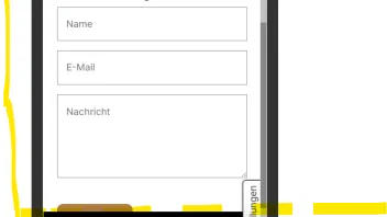

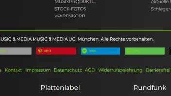

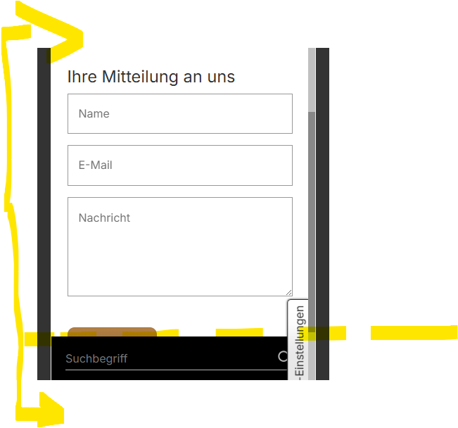

Der Footer (#footer) wird durch das integrierte Skript placeFooter() mit position: absolute am unteren Viewport-Rand positioniert. Dies führt dazu, dass der Footer bei umfangreicherem Seiteninhalt den letzten Container (z. B. #container_126) überlappt und dadurch Inhalte abgeschnitten oder nicht mehr vollständig sichtbar sind.
Da eine Anpassung des System-JavaScript-Codes in Zeta Producer leider nicht vorgesehen ist, musste ich das Problem durch ein eigenes Script umgehen, das beim Laden der Seite den Footer wieder auf position: static setzt und das durch placeFooter() gesetzte padding-bottom auf dem body entfernt.
Ich würde es begrüßen, wenn das Standardverhalten des Footers überarbeitet oder optional angepasst werden könnte – z. B. durch eine intelligente Platzierung, die den tatsächlichen Dokumentenfluss berücksichtigt, oder durch einen optionalen Sticky-Footer, der nur bei kurzen Seiteninhalten verwendet wird.
Bis dahin umgehe ich das Problem wie folgt:
<script>
window.addEventListener("load", function () {
setTimeout(function () {
var footer = document.getElementById("footer");
// Footer aus dem absoluten Layout zurückholen
footer.style.position = "static";
// Padding entfernen, das vom ursprünglichen Script hinzugefügt wurde
document.body.style.paddingBottom = null;
}, 500);
</script>
Lad die Seite nach dem Umschalten auf die mobile Ansicht / verkleinern des Browserfensters mal neu, dann passt es.
Nein. Das Problem ist auch mobil auf dem Handy und für Nutzer nicht zumutbar. Das Layout ist instabil!
Immer der letzte Container wird vom Footer überlappt. Auf jeder Seite.
Das das niemanden auffällt ist mir echt ein Rätsel.

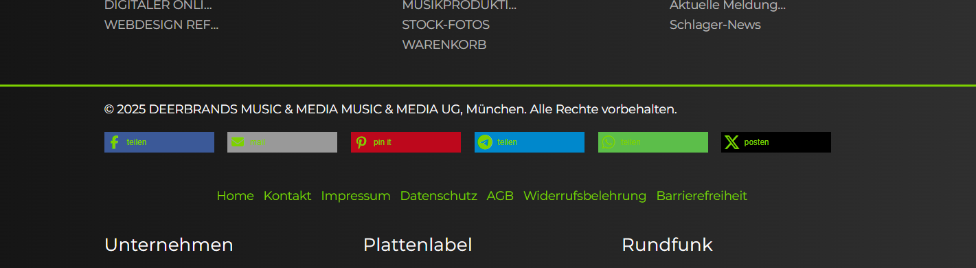

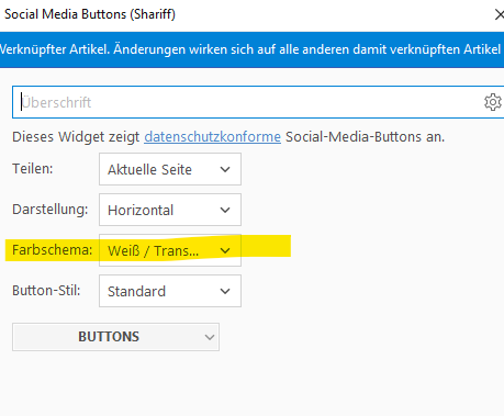

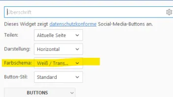

Liebes Zeta-Team,
das Farbschema "weiß/transparent" geht nicht. Button bleiben bunt.
Musste ich per CSS erzwingen:
.shariff a {
background-color:transparent!important;
VG
Der Fehler ist per Online-Update für Version 17 behoben. In frühestens 30 Minuten auf "Extras > Updates suchen" klicken und nachdem Inhalte geladen wurden (Hinweis oben im Fenster) die Tastenkombination STRG-SHIFT-T drücken. Danach ggf. veröffentlichen.

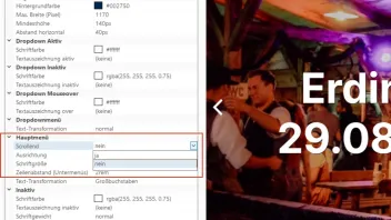

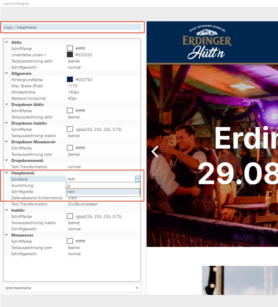

(Layout) Design Einstellungen Header ist IMMER fix: scrollend JA UND Nein!
In den Layouteinstellungen habe ich den fixierten Header deaktiviert, und ZP Programm funktioniert die Einstellung auch korrekt.
Allerdings bleibt der Header in der Vorschau und nach der Veröffentlichung weiterhin fixiert, unabhängig von der gesetzten Option beibt "header. fixed" bestehen. Offenbar wird die Einstellung im veröffentlichten Code ignoriert oder übersteuert.

Hallo liebes Zeta-Team,
mir ist aufgefallen, dass bei Verwendung von Einblendeffekten wie „von rechts einfahren“ auf mobilen (iPhone 15 Pro) Geräten ein unschöner Effekt entsteht: Die Seite beginnt beim Scrollen zu wackeln, solange die Animationen laufen. Ursache ist offenbar, dass animierte Elemente kurzzeitig außerhalb des sichtbaren Bereichs positioniert werden und dadurch ein horizontaler Scrollbereich entsteht.
Ein Workaround ist folgender CSS-Code:
Das unterbindet das horizontale Scrollen und behebt das Wackeln. Es wäre schön, wenn dieser Effekt automatisch durch das CMS verhindert wird, z. B. durch geeignetes Standardverhalten bei den Einblendeffekten oder durch eine systemseitige Begrenzung des Überlaufs.
Ich würde mich freuen, wenn das in einem zukünftigen Update berücksichtigt wird (wenn möglich). Ich habe dies in den Globalen CSS-Einstellungen vorab eingebunden.
ZP Version 70.0.1 Business
VG Mirco
