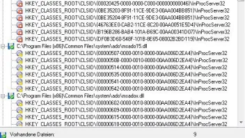

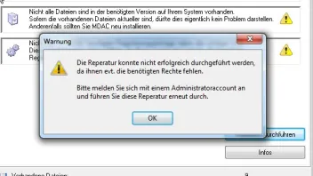

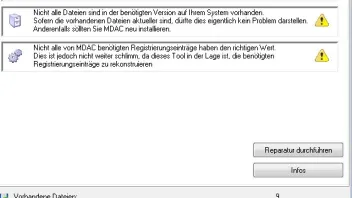

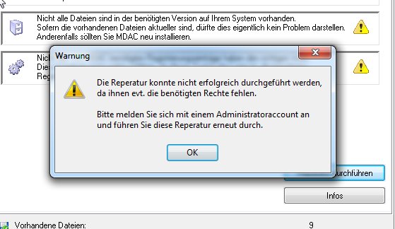

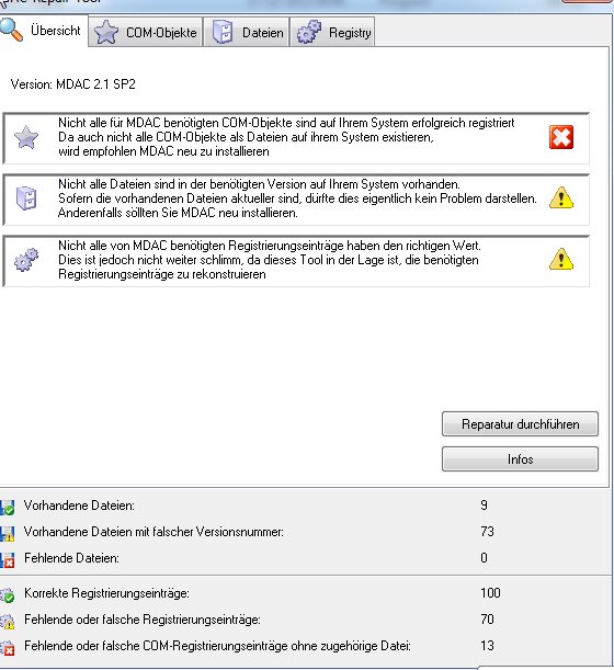

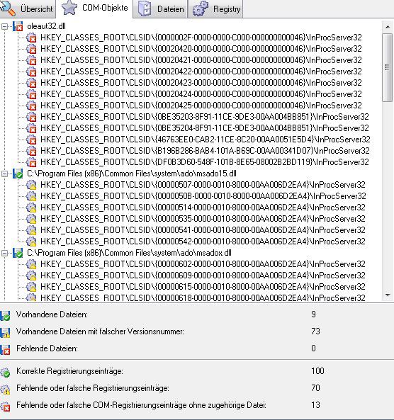

Hello
Now I have downloaded the file and opened it and put it to repair the database?
Both versions of Producer v 9 and the free v. 11 is of course closed when I try to repair the database.
It just did not and when I open Producer v 9 and 11, it seems they still do not.
When I press the "Datein" in the program then freezes the program and it can not be closed down generally. Then I shut it down with / in the job list.
I have attached a few pictures that might describe the errors better for you.
Looking forward to hear what I have to try.
I can just say that I have repeatedly deleted the 2 versions of Producer and installed them again. There are also removed remnants of programs in the registry file.
