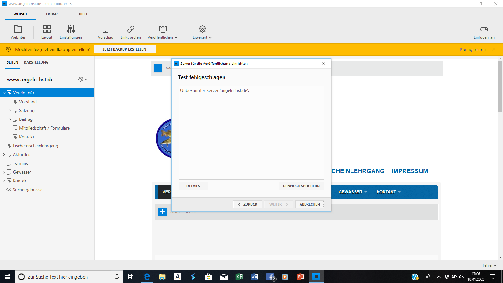

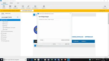

Folgende Fehlermeldung erscheint beim Test der SFTP Verbindung:

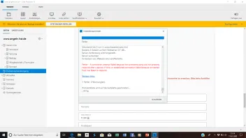

Rebex.Net.SftpException

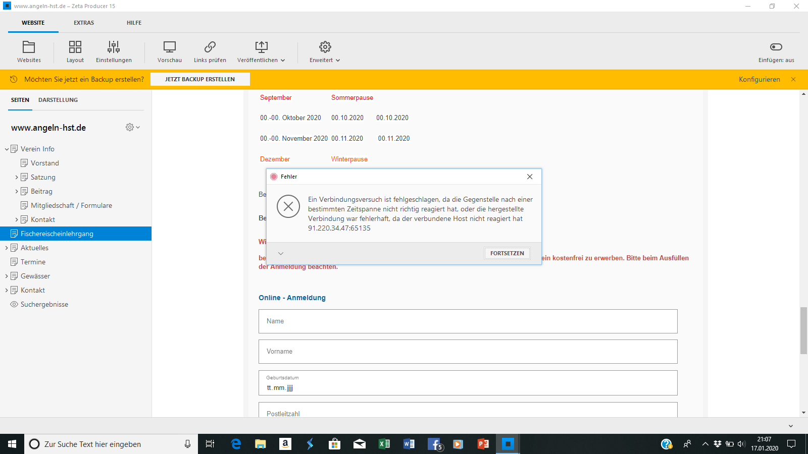

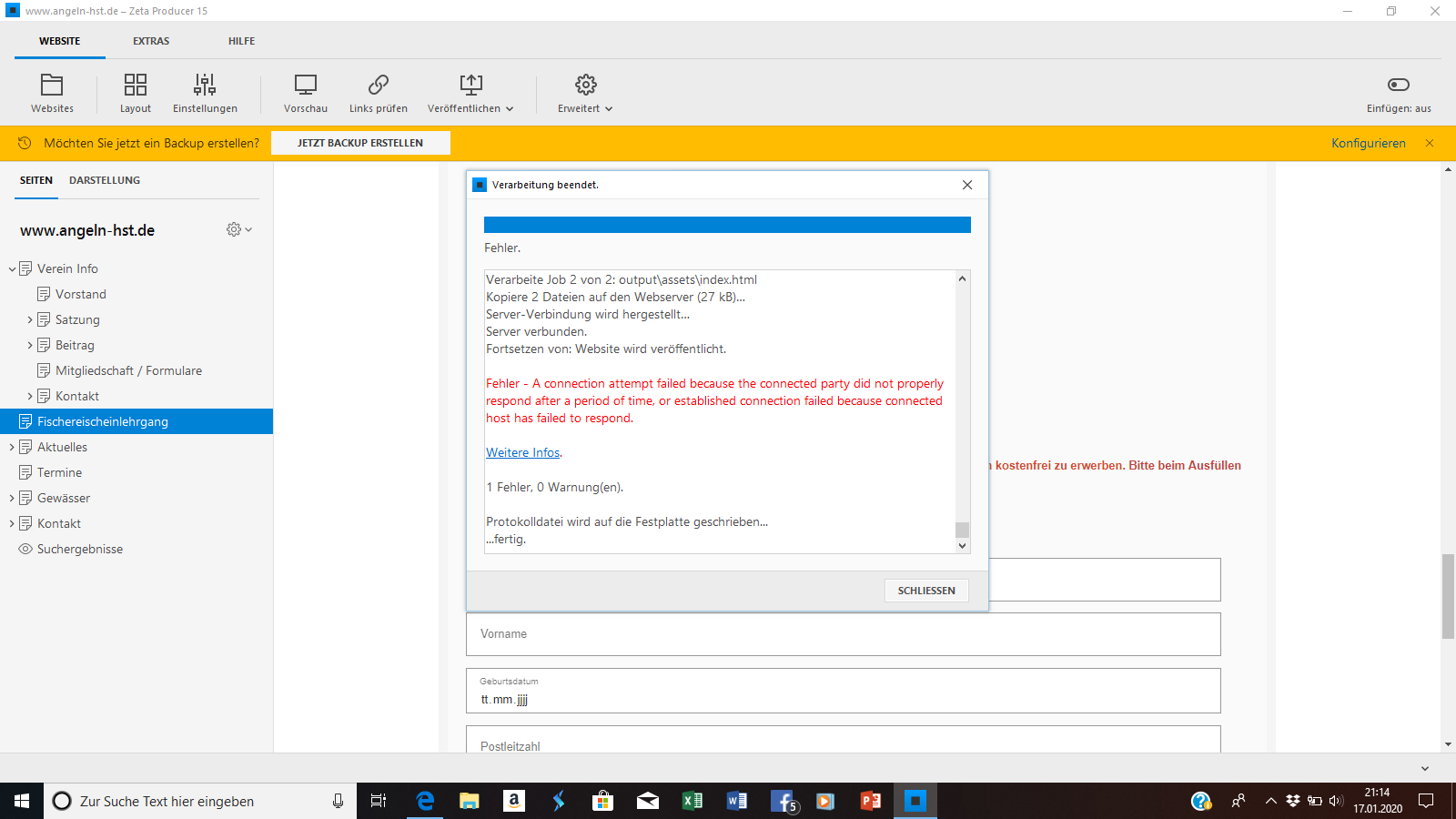

A connection attempt failed because the connected party did not properly respond after a period of time, or established connection failed because connected host has failed to respond.
bei Rebex.Net.Sftp.ypka(String qi, Int32 qj, SshParameters qk, ctch ql)
bei Rebex.Net.Sftp.ypjz(String qf, Int32 qg, SshParameters qh)
bei ZetaProducerPublishing.Runtime.Protocols.SftpProtocol.SftpEngine.DoOpen(OpenInformation information) in c:\P\ZP\14.3\ZetaProducerPublishing\Source\Runtime\Protocols\SftpProtocol\SftpEngine.cs:Zeile 215.
bei ZetaProducer.RuntimeBusinessLogic.Publishing.Testing.ConnectionTestController.doTestRunNormal(Cancelable cancelable, Boolean quickTestOnly) in c:\P\ZP\14.3\ZetaProducerMain\Source\Core\RuntimeBusinessLogic\Publishing\Testing\ConnectionTestController.cs:Zeile 89.
bei ZetaProducer.RuntimeBusinessLogic.Publishing.Testing.ConnectionTestController.Test(Cancelable cancelable, Boolean quickTestOnly, Boolean allowThrow) in c:\P\ZP\14.3\ZetaProducerMain\Source\Core\RuntimeBusinessLogic\Publishing\Testing\ConnectionTestController.cs:Zeile 47.
SftpException
Status=ConnectFailure,
Code=UnknownError,
Transferred=0,
RemotePath=null,
LocalPath=null,
ProblemType=0,
ProtocolCode=null,
ProtocolMessage=null,
Message="A connection attempt failed because the connected party did not properly respond after a period of time, or established connection failed because connected host has failed to respond.",
Data=
"SftpStatus" = ConnectFailure
"Status" = ConnectFailure
InnerException=ProxySocketException
ErrorCode=10060,
ProtocolCode=null,
Data=
"ProxyStatus" = ConnectFailure
"ErrorCode" = 10060
InnerException=SocketException
ErrorCode=10060,
Message="Ein Verbindungsversuch ist fehlgeschlagen, da die Gegenstelle nach einer bestimmten Zeitspanne nicht richtig reagiert hat, oder die hergestellte Verbindung war fehlerhaft, da der verbundene Host nicht reagiert hat 80.150.6.150:22",
