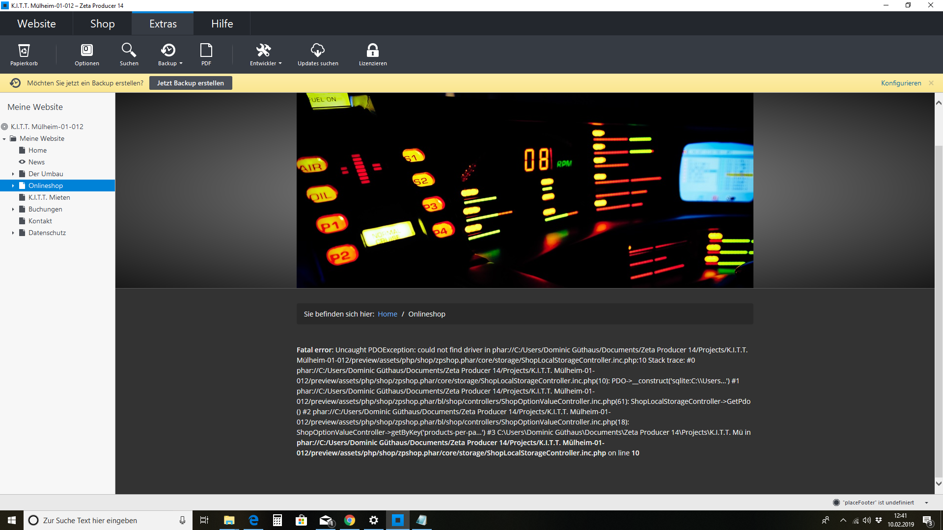

    Ich habe seit geraumer Zeit Probleme, meinen Onlineshop in Zeta Producer aufrufen zu können.
    Mir wird immer folgender Fehlercode angezeigt!
    <b>Fatal error</b>: Uncaught PDOException: could not find driver in phar://C:/Users/Dominic Güthaus/Documents/Zeta Producer 14/Projects/K.I.T.T. Mülheim-01-012/preview/assets/php/shop/zpshop.phar/core/storage/ShopLocalStorageController.inc.php:10
    Stack trace:
    #0 phar://C:/Users/Dominic Güthaus/Documents/Zeta Producer 14/Projects/K.I.T.T. Mülheim-01-012/preview/assets/php/shop/zpshop.phar/core/storage/ShopLocalStorageController.inc.php(10): PDO-&gt;__construct('sqlite:C:\\Users...')
    #1 phar://C:/Users/Dominic Güthaus/Documents/Zeta Producer 14/Projects/K.I.T.T. Mülheim-01-012/preview/assets/php/shop/zpshop.phar/bl/shop/controllers/ShopOptionValueController.inc.php(61): ShopLocalStorageController-&gt;GetPdo()
    #2 phar://C:/Users/Dominic Güthaus/Documents/Zeta Producer 14/Projects/K.I.T.T. Mülheim-01-012/preview/assets/php/shop/zpshop.phar/bl/shop/controllers/ShopOptionValueController.inc.php(18): ShopOptionValueController-&gt;getByKey('products-per-pa...')
    #3 C:\Users\Dominic Güthaus\Documents\Zeta Producer 14\Projects\K.I.T.T. Mü in <b>phar://C:/Users/Dominic Güthaus/Documents/Zeta Producer 14/Projects/K.I.T.T. Mülheim-01-012/preview/assets/php/shop/zpshop.phar/core/storage/ShopLocalStorageController.inc.php</b> on line <b>10</b><br>

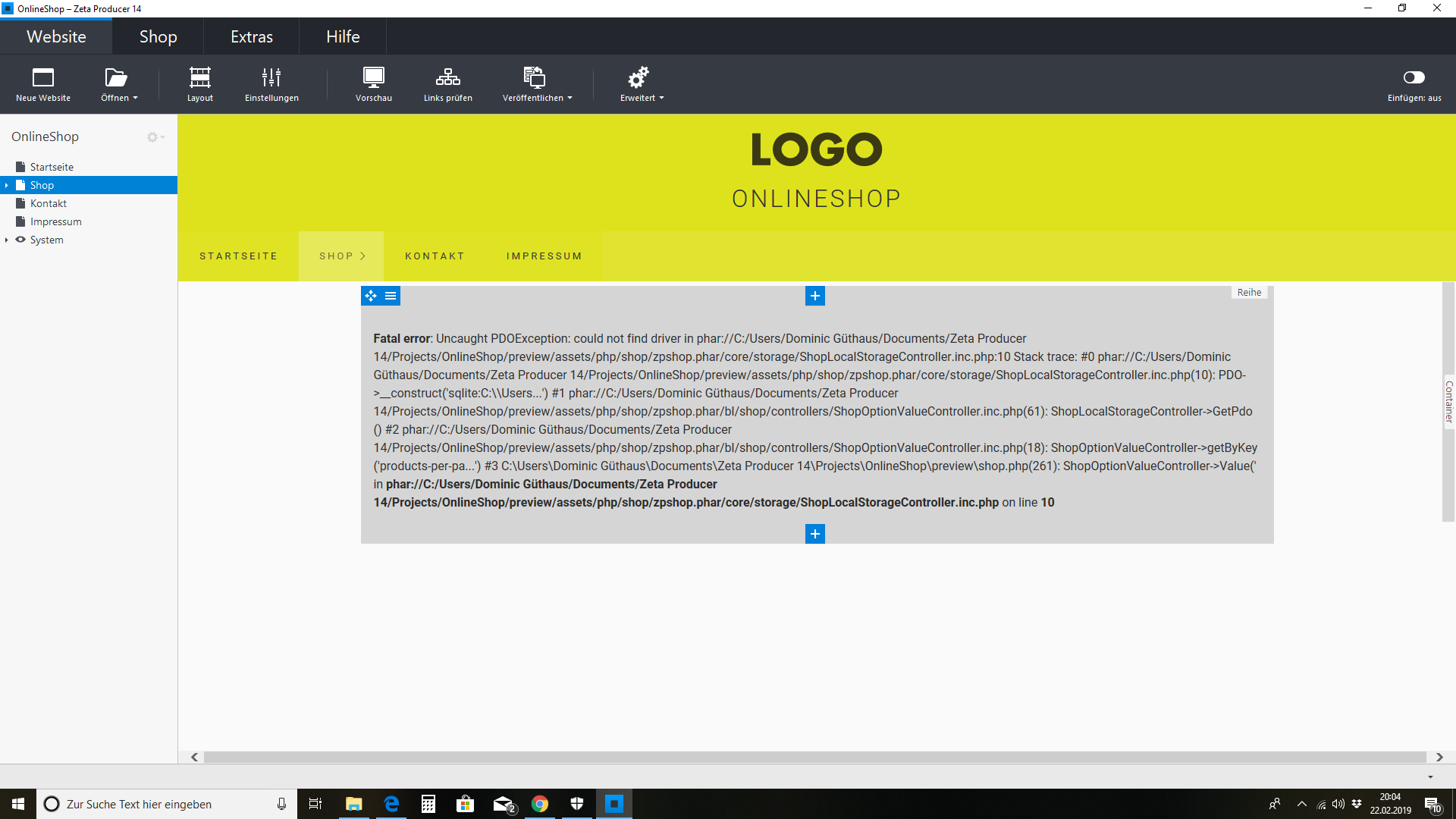

    Auch beim Erstellen eines neuen Onlineshops erhalte ich selbige Fehlermeldung!
